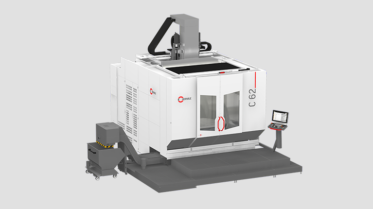

C 62 / C 62 U MT GEN2 Machining centre
"State of the Art" CNC machining – this is what the C 62 / C 62 U MT GEN2 stands for as the top model of the HERMLE High-Performance Line and the entire product range.
The highly dynamic machining centre represents ultimately consistent design for efficient machining of CNS milled parts and CNC turned parts. Numerous features ensure high-precision and cost-effective working on workpieces up to 2500 kg in weight. Various optional extras simply add to the capabilities for innovative advanced machining. As with all HERMLE machining centres, the C 62 / C 62 U MT GEN2 offers various workpiece loading options to guarantee optimum operation.
From the comprehensive fluid technology to the optimised chip management system and a range of cooling lubricant units to the hinged belt conveyor: This High-Performance Line model has a number of highlights to offer, e.g. the right chip disposal equipment for removing all types of chip from the working area. This high-performance machining centre can be transported without being dismantled and set up without a foundation.
Technical Data
Dimensions
  • Traverse path:  1200 x 1300 x 900 mm
  • Body:  Ø 1200 / H 900 mm
  • Collision circle:  Ø 1400 mm
  • Vertical table clearance:  max. 1100 mm
Facts
  • Rotational speed: 9000/14000/18000 1/min
  • Rapid traverse linear X-Y-Z: 50 m/min.
  • Swivelling rotary table: Ø 1350 x 1100 mm
  • Max. table loading: 2500 kg

  • Chip conveyor

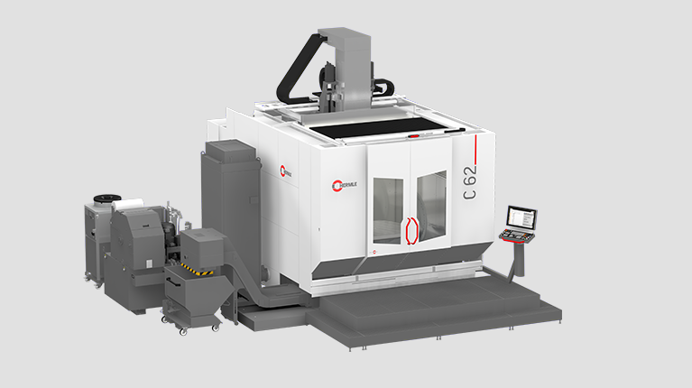

  • Chip conveyor with internal cooling lubricant supply ICS 80

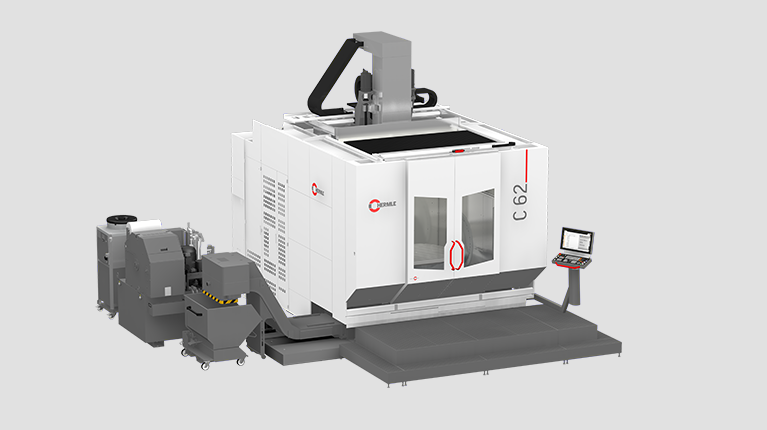

  • Chip conveyor with internal cooling lubricant supply ICS 80 and temperature controller
  • Chip conveyor with internal cooling lubricant supply ICS 80, temperature controller and emulsion mist extraction
