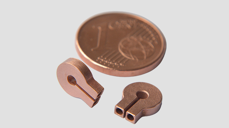

Thin mould cores
For thin mould cores where it is not possible to incorporate a cooling channel, we specifically use copper solutions to improve heat dissipation. This allows heat to be dissipated more quickly and makes the process significantly more stable.

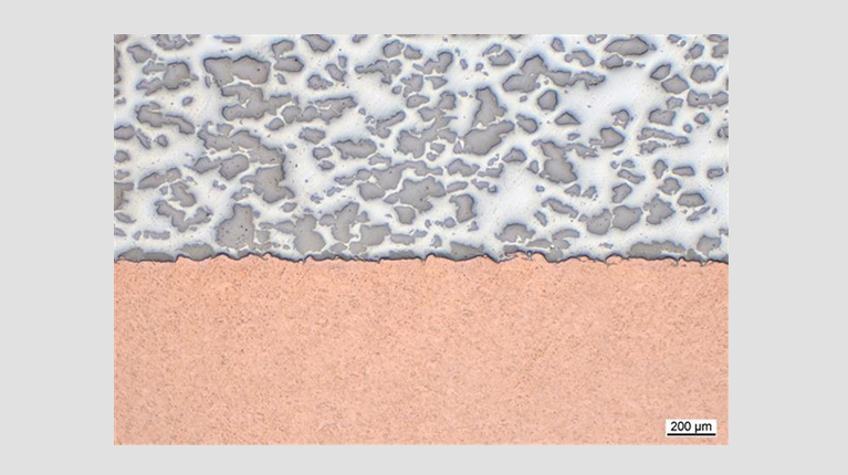

Cooled sputter targets
Our cooled sputter targets ensure efficient dissipation of the heat generated during sputtering and thereby stabilise the coating process.
The challenge lies in the thermal interface between the target material and the cooling structure, which we optimally resolve by applying a copper backplate directly using MPA without any soldering – even with material combinations whose melting points differ vastly, such as aluminium and titanium. Moreover, integrated cooling ducts that can be formed in the copper further improve heat dissipation.

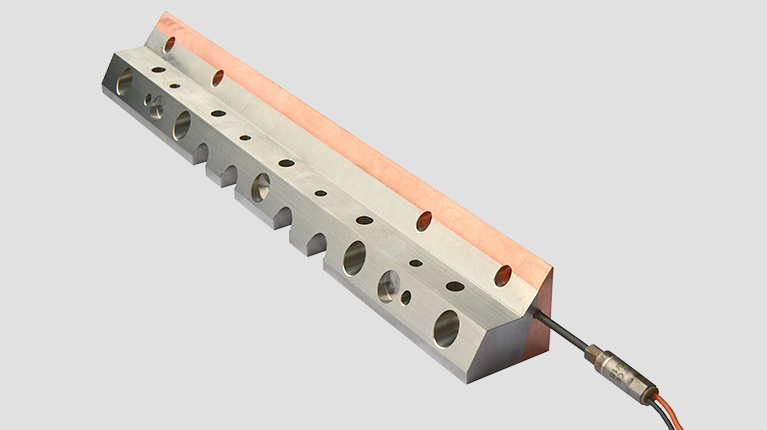

Sealing bars for producing spout pouches
Our sealing bars ensure precise and consistent temperature control when sealing spouts in plastic pouches. The challenge lies in reliably controlling the temperature of complex sealing contours, which we solve optimally by selectively integrating copper in stainless steel using MPA technology. This allows us to achieve the highest temperature accuracy at the sealing edge, thereby significantly improving process stability, component quality and repeatability.
Welding bars for the packaging
Our welding bars ensure efficient and precise heat transfer to the welding edge when cutting and sealing plastic pouches. The challenge lies in the precise temperature control of complex geometries, which we master through a carefully engineered combination of materials: high thermal conductivity copper and robust, chemically resistant stainless steel. This way, we achieve a rapid temperature response, high process reliability and consistently clean weld seams.

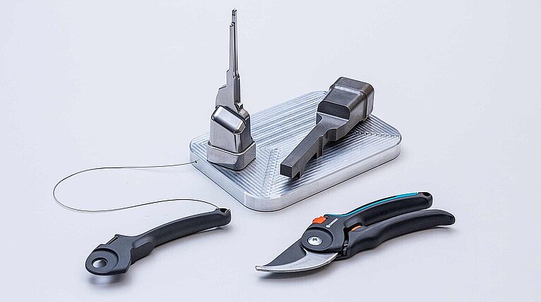

Temperature-controlled glue nozzle
Our temperature-controlled glue nozzles ensure that glue is consistently applied within a precisely defined temperature range. The challenge lies in achieving precise and stable temperature control, which we reliably ensure by integrating heating elements and using copper-based MPA technology to provide an optimised thermal connection. This results in compact tools with rapid heat transfer, high process consistency and reproducible product quality.

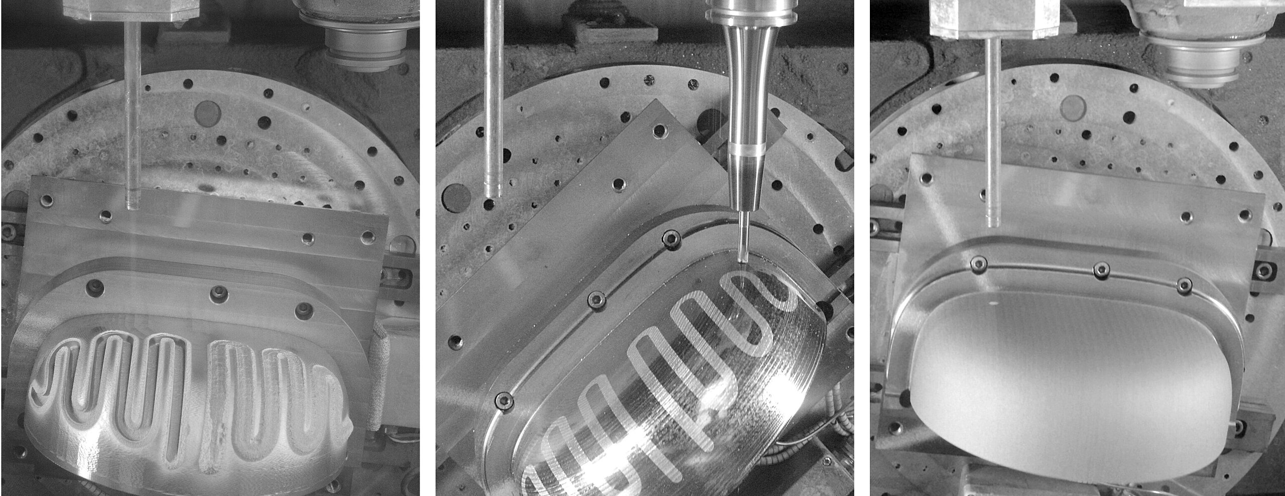

Additive build-up on semi-finished parts
Each of these three mould inserts features a cooling duct that follows the surface. Blanks, into which the corresponding ducts were milled, were utilised during production. Compared to the fully additive manufacture of the mould insert, the use of the semi-finished part is significantly more cost efficient. The proportion of additive manufacturing is limited to the filling of the ducts with water-soluble filling material and the subsequent application of the respective steel top layer (highlighted blue in the image). The 5-axis simultaneous machining capabilities of the machine were utilised for application of the top layers to ensure an even application on the curved component surface. For the two components on the right in the image, the layer was built up radially while the component was rotating.
  • Collage: Bauteile Aufbau auf Rohling mit markierten Auftragsflächen

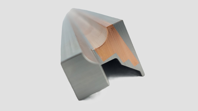

Integrated copper cores for heat conduction
  • Collage: Kupfer Stahl Kombinationen
The MPA process allows for the combination of multiple materials in one component. Of particular interest here are copper elements that are integrated into steel components as heat conductors. In the components shown here, copper is inserted at points where cooling via a duct poses geometric challenges. In most cases, heat is then transported via the copper elements to a slightly more distant cooling duct. In the MPA machining centre, pure copper is applied to pre-milled copper geometries in an additional step, following the filling of respective cooling ducts with water-soluble material, to produce such components. A direct thermal contact is created between the copper and the steel substrate.
