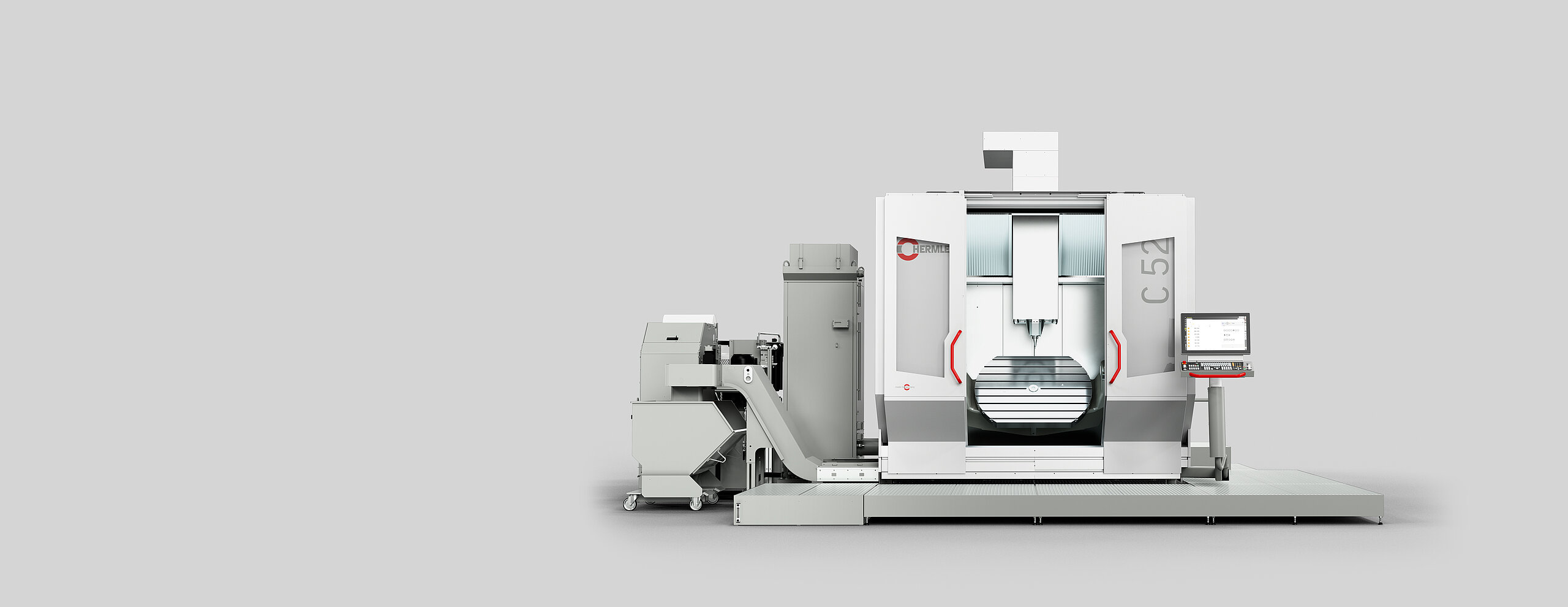

Technical Data
Dimensions
Traverse path: 1000 x 1100 x 750 mm
Body: Ø 1100 / H 810 mm
Collision circle: Ø 1290 mm
Vertical table clearance: max. 950 mm
Facts
Rotational speed: 9000/14000/18000 1/min.
Rapid traverse linear X-Y-Z : 60–60–60 m/min.
Swivelling rotary table: Ø 1150 mm
Max. table loading: 2000 kg
