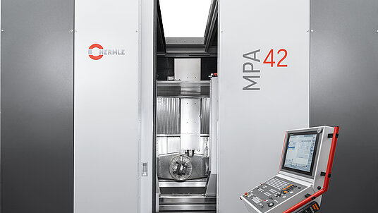

The HERMLE MPA technology (metal powder application) is a highly innovative, unique manufacturing process that integrates additive and subtractive machining within a hybrid machine concept.

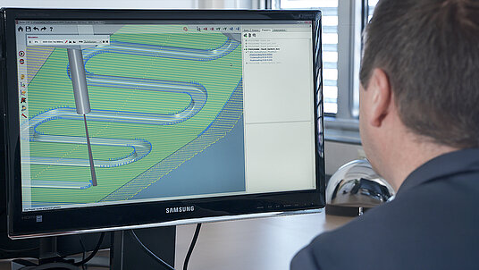

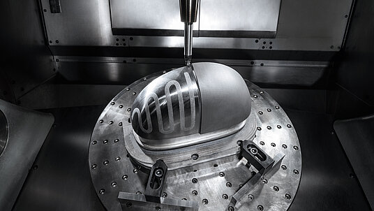

Once the order has been placed, we create the production specifications and program the machining operations in our in-house CAM system. The base bodies are then prepared on our milling machining centres – using automated processes where required. Components are continuously measured and inspected throughout the entire process.
Step - 5

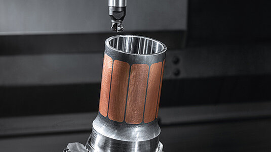

MPA manufacturing
The defined areas are manufactured additively in the agreed MPA setup. Application and milling are performed alternately according to the production specifications. Process parameters are monitored, recorded and stored ensuring full traceability down to individual components.

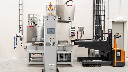

Heat treatment
We perform specialised heat treatment tailored to our customers’ requirements and specifications. Process and batch data are assigned to the component and documented.

Milling process and quality assurance
We mill the final contour or, depending on the agreement, leave a defined allowance (a few millimetres) for final finishing. Accompanying quality and process inspections ensure that the target geometry is achieved. Measurement and test results are reliably documented.
