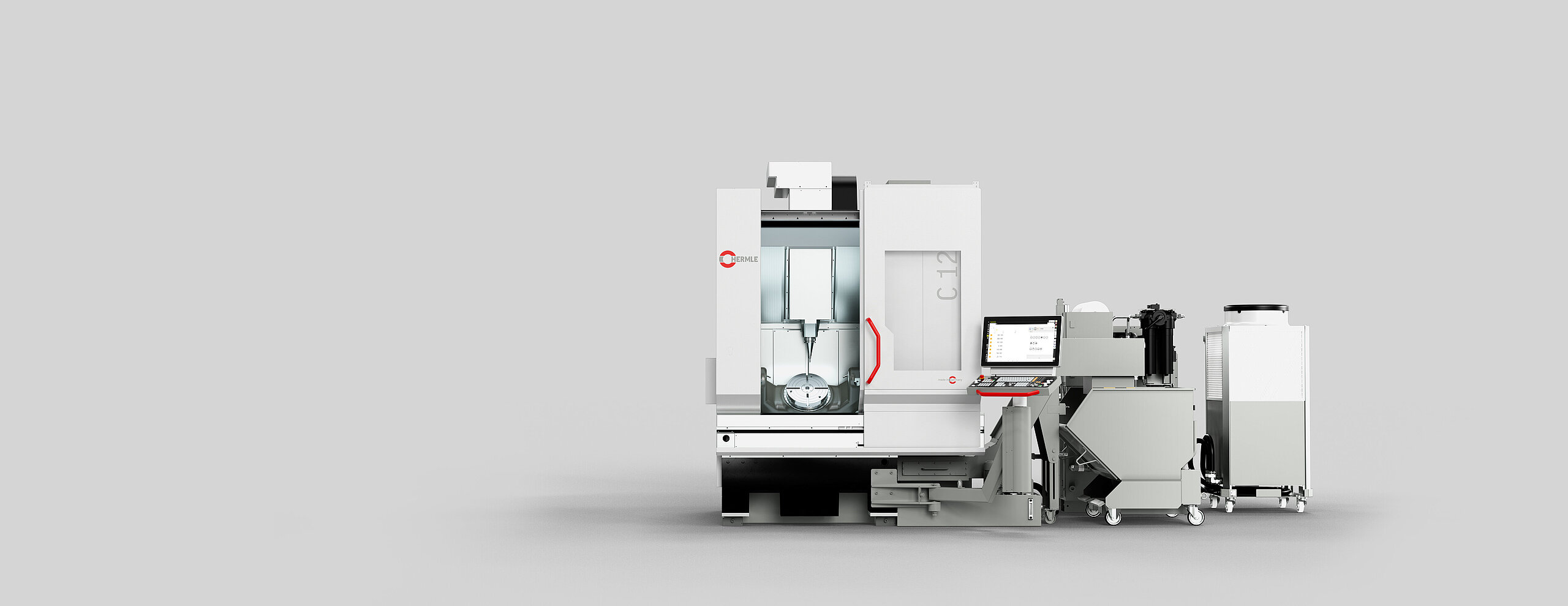

Maximum efficiency combined with a small footprint: The C 12 is the most compact HERMLE machining centre in the High-Performance Line.
Designed for machining cubic parts up to 100 kg and is more than a match for larger models. The right speed is available for practically every application. The especially compact and space-saving C 12 machining centre meets the ever increasing demands placed on speed and precision thanks to the corresponding HERMLE setups. It goes without saying that there are also many options available for more complex applications.
From the comprehensive fluid technology to the optimised chip management system and a wide range of cooling lubricant units: The entry-level model of the High-Performance Line has a number of highlights to offer, e.g. the right chip disposal equipment for removing all types of chip from the working area. The especially compact and space-saving machining centre can be transported without being dismantled and set up without a foundation.
