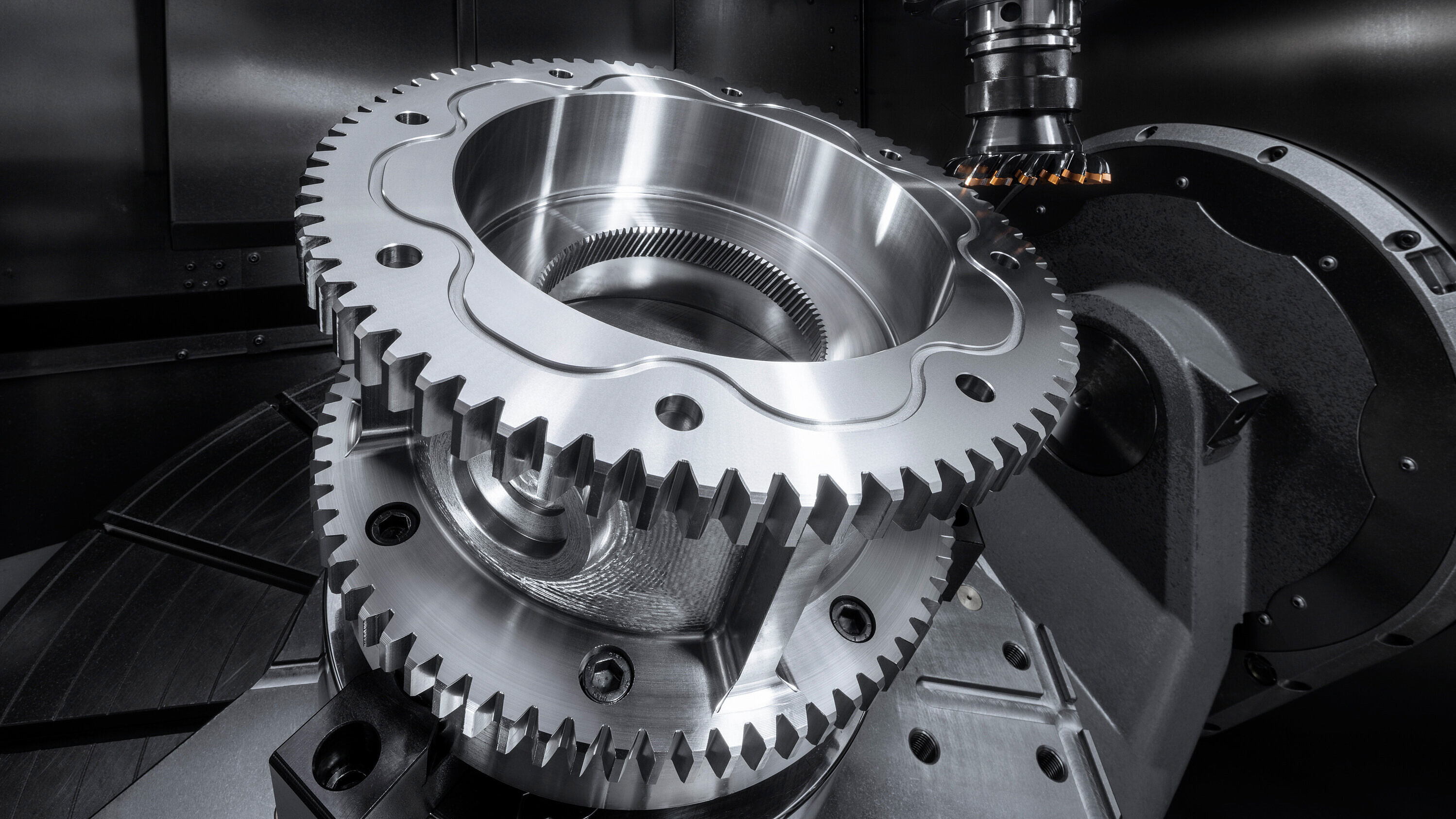

Maschinenfabrik Berthold HERMLE AG will be exhibiting its innovative solutions at Stand C31 in Hall 7 at AMB. On a C 42 U MT (mill/turn) machine, HERMLE presents a technological showcase of the highest calibre. Thirteen manufacturing technologies combined in a single component clearly demonstrate the performance of HERMLE products.
Contour smoothing | reverse countersinking | diamond smoothing | power skiving | simultaneous deburring | grinding / dressing | interpolation turning | drilling Ø 70 with the C axis | temperature probes | ultrasonic probes | ACM (Adaptive Control and Monitoring) - all combined in one component.

  • HERMLE Technology component with 13 technologies
