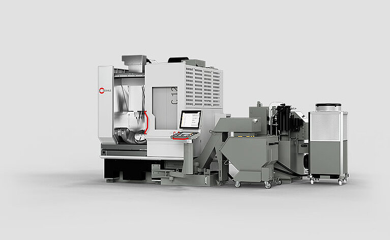

Small details with a big impact.
Comprehensive fluid technology, diverse coolant equipment and optimised swarf management – machining centres from HERMLE impress thanks to their intelligent details.
Coolant management
  • Space-saving setup
  • Internal cooling lubricant supply
  • Temperature controller
  • Emulsion mist extraction system

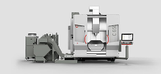

HERMLE Zusatzmagazin
Room for more Additional magazines make it possible
  • Increased productivity and system uptime
  • Especially for automated systems or complex machining operations with many tools
  • for space-optimised extension of the tool storage capacity
  • Fast adaptation and commissioning possible
  • All additional magazines can be retrofitted to a limited extent
Overview of additional magazines
Additional magazine ZM 30
  • Available for C 650, C 32, C 42 GEN2
  • 30 additional magazine pockets
  • Max. tool weight: 8 kg
  • Max. tool diameter Ø 80, with corresponding side pocket assignment Ø 125 mm
  • Max. tool length: 350 mm
