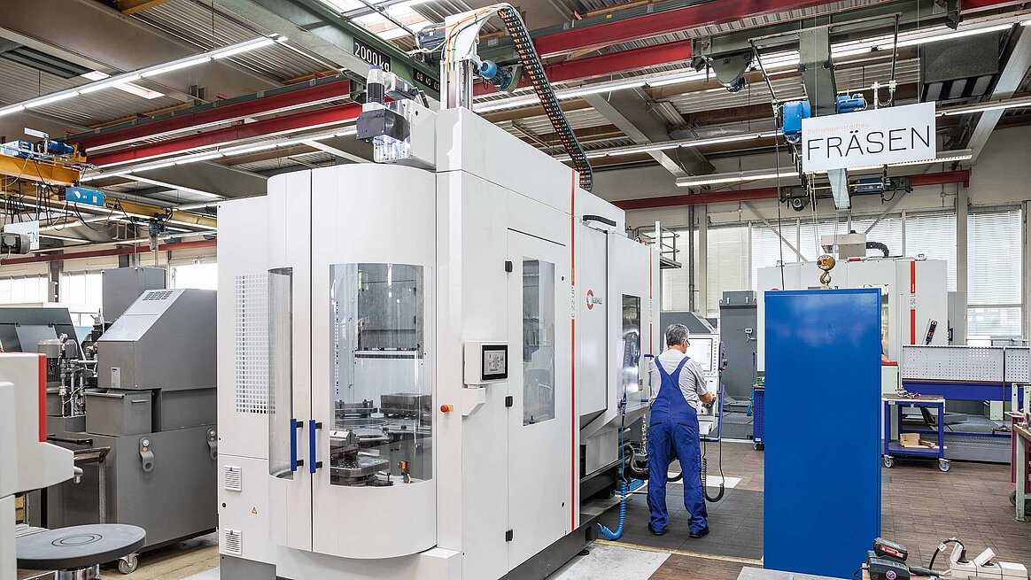

  • Palettenwechsler PW 150 zum BAZ C 22 UP von Hermle
    The PW 150 pallet changer of the C 22 UP machining centre; in the foreground is the (rotatable) setup station for loading the pallets/workpiece fixtures with workpieces or for removing the finished parts.
  • Arbeitsraum des BAZ C 22 UP von Hermle, in welchem ein Werkstück gefertigt wird
    The working area of the machining centre C 22 UP with the swivelling rotary table measuring 320 mm in diameter (axes A and C) for 5-axis complete/simultaneous machining of tool components in a single setup.
