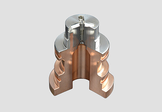

Vorkammerbuchse - Generativ gefertigt durch die HERMLE Maschinenbau GmbH
Four materials combined in a single component
The revolutionary pre-chamber nozzle shown here, designed for plastic injection moulding, combines four metallic materials in a single component, thus showcasing the full potential of HERMLE MPA technology. The aim is to apply specific properties exactly where they are needed – rather than relying on a compromise base material for all tasks. The result: more stable process windows in the injection area, targeted protection against wear and corrosion as well as effective heat dissipation.

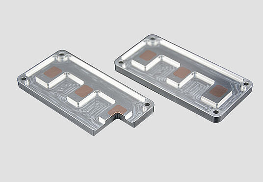

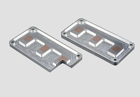

Multimaterial-Leiterplatten - Generativ gefertigt von der HERMLE Maschinenbau GmbH
Aluminium board with Cu inlays: Solder quality and passive heat dissipation

Cooler thanks to copper in the core
S&S Werkzeugbau GmbH
Spritzgusstechnik
Tool and mold making
S&S Werkzeugbau manufactures complete injection moulds entirely in-house – from design through to the initial moulding. However, the mould makers make an exception in the case of a reliable cooling solution for narrow cross-sections: Hermle Maschinenbau uses metal-powder application technology (MPA) to integrate copper into mould cores, thereby optimising heat outflow in the injection moulding process.
